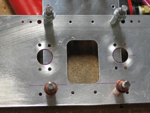

Brief Description:  F-706 BH - Match drill snap bushing hole, Part 1.
The 730 Reinf. plate is the first of 3 layed parts that get matched to the 706B bottom bulkhead. Get the holes in the proper location on the bottom 706B and the other parts are easy to match fit. Get the first holes wrong and several other parts get messed up.
Image 1 shows what needs to be trimmed away from the 730 reinf plate. I drilled as much of it away as I could. Then used a small dremal sanding drum to smooth it out..
Mark what gets trimmed away.
Drill most of it.
Drill most of it.
Finish with sanding drum.
