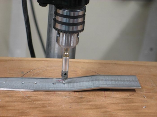

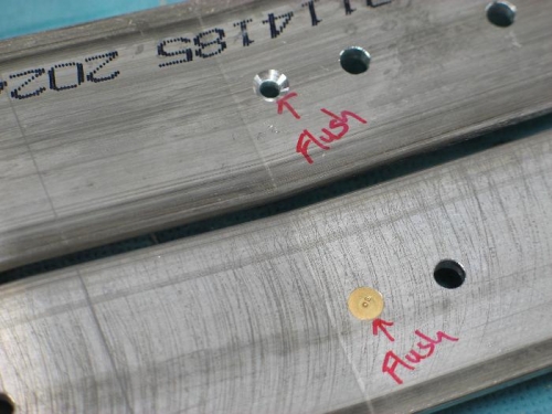

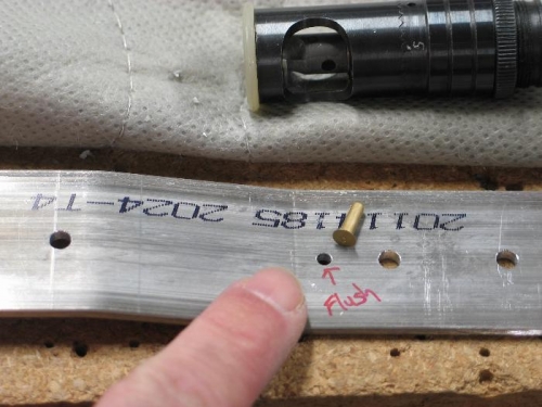

F-705 BH - 605C counter sunk hole.
The 605C has one counter sunk hole that will be under a 634 seat belt anchor. Each side gets one hole counter sunk, total of 2.
Problem, this hole is to closs to the bend to use even the small radius counter sink cage. So, I used the drill press. Worked good.
Is this the righht hole?
Don'y over drill it.
Oh good, perfect. Happy.
