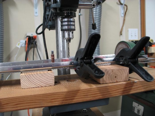

Make sure you get the 705 level on your drill press table for drilling. I used spacers of sorts to get it level.

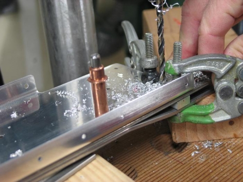

The interior end of the 605C gets a tapered cut. I think it's best to make this cut after all the holes are drilled. Keeping this part square makes it easier to position correctly and clamp in place.

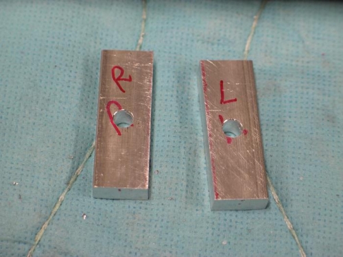

Image 3 shows the holes are centered in the spacers. The plans top view of the 705 shows that the holes are centered.
Level on drill press table.
Drill spacer to #12.
Oh good. Holes are centered.
