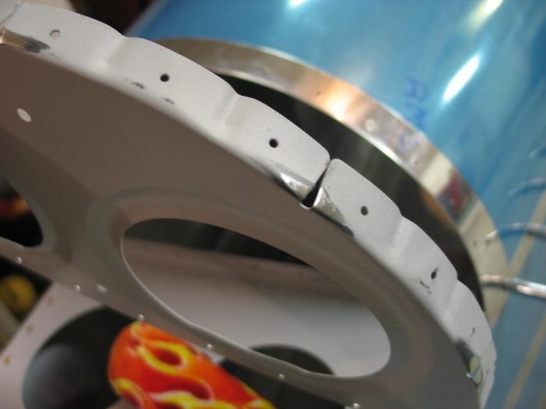

Brief Description:  Final Drill AFt F709 Bulkhead
This aft bulkhead required a small bit off adjustment. The sides of the bulkhead required heavy fluting and as seen in image 1, I sanded the bulkhead flange in 4 spots. These spots were a bit lifted and actually bumped the top skin upward. Much better fit of upper skin after sanding these flange intersections.
Sand smooth flange intersections.

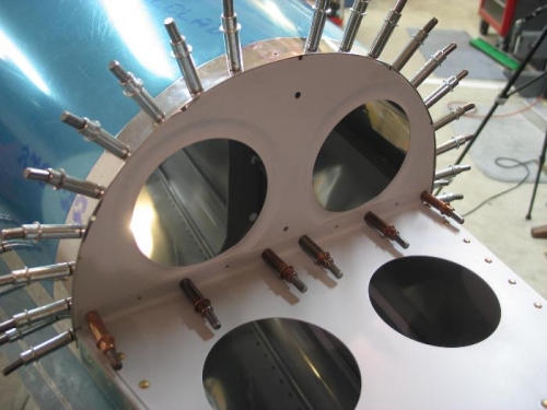

F709 clecoed in place.

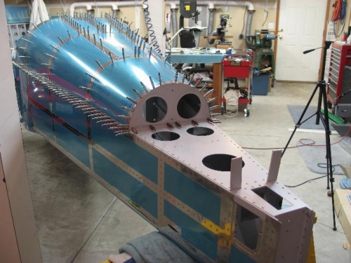

Aft f709 bulkhead in place.
