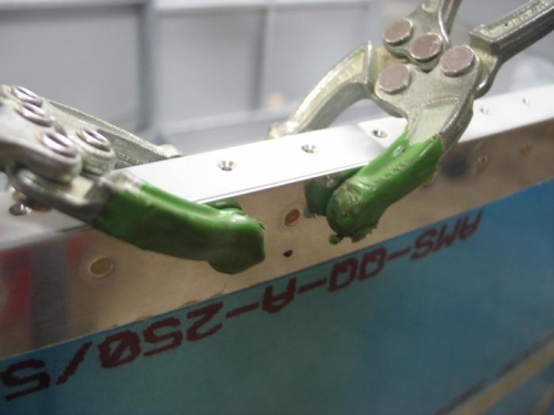

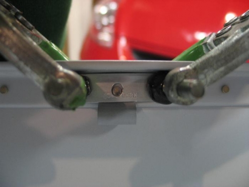

It took a moment to figure out how to rivet these static line clips. You see the clip is sprung open so you need a way to clamp it closed to rivet.

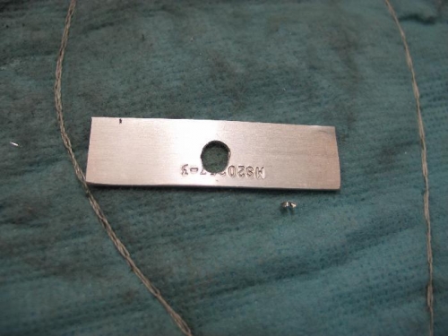

Image 3 shows this little piece of scrap I used to clamp over the clip to squeeze it shut and still have room the pneumatic squeezer. Worked well, went fast.
I hade to squeeze them just a bit more after taking the clamp scrap off.
Clamp shut static line clip.
Squeeze over clamp starp.
Static line clip clamp strap.
