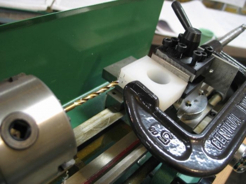

I’ve used my little lath to drill all the holes in all the bearing blocks. Does a great job compared to what I imagine the drill press would do.

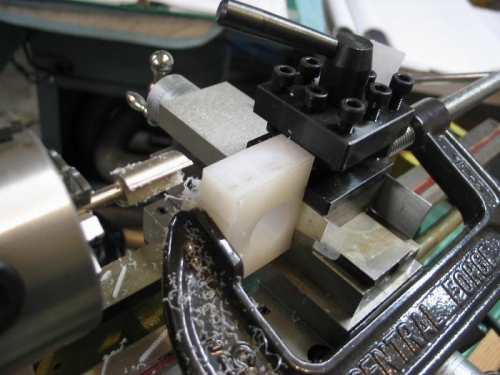

I also used it to cut the 1/16” deep groove. Finally cut it in half with the band saw. So far this part is acceptable. The problem that caused me to remake it is coming up.
Drill holes in flap center block.
1/16
1/16" groove.

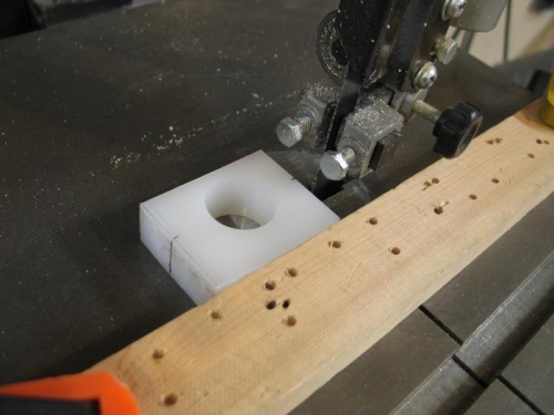

Split with band saw.
