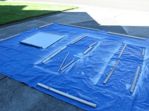

More priming. Side main skins and forward bottom skin.
I used a new $20 dollar spray gun It’s good for large surfaces. Worked well.

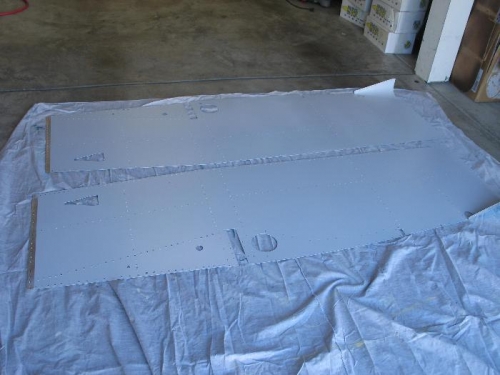

I taped off about an inch where the side skins and forward bottom skin will mate with the firewall. I've heard that I'll be using firewall sealant and wanted the mating surfaces to be free of primmer.
Small boards elevate edges.
Inside to dry.
Inside to dry.
