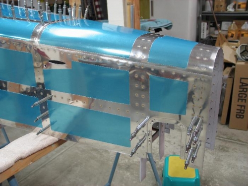

Brief Description:  Rivet aft bottom fuselage side skins.
Well, I didn't take any incremental pictures of the rivet process. I turned it over to rivet the bottom skin as shown in the pictures. I riveted the side skins with it turned right side up and was able to do all of them myself with the tungstun bucking bar. I'll need help on the rest of them.
The order that I riveted was.
1.) Bottom J Stiffener.
2.) Up the bulkheads to the top J Stiffener.
3.) Top Stiffener.
4.) Tail cone.
Turned over ready to finish it off.
