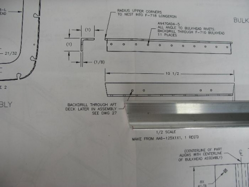

It took a while to figure out the angles required at the ends of the 710B angle. The plans show 2 views and it just was not making sence. The top picture of this part shows a notch even though the end has just one straight cut? Well it actually makes sense now.
Once the 710B is cut to length and the ends are angled, clamp and drill using the 710 bulkhead as a drill guide.
