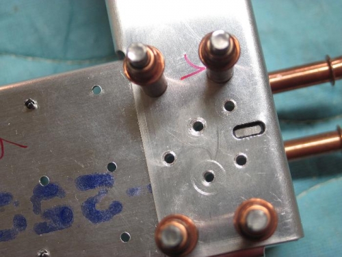

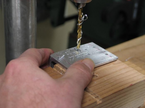

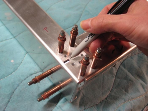

Time to drill the slot in the 705G. First cleco it in place and mark the outline of the slot as in image 1 and 2. Then dill using a 3/16" bit. I didn't clamp the piece down on purpose. I have found that on thick stock, I can fine adjust the hole center by adjusting the workpiece position as the drill begins to bite.
Cleco 705G in place.
Mark with sharpie.
Mark with sharpie.
Drill 3/16
Drill 3/16" in center nof slot mark.
