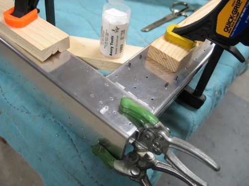

Brief Description:  F-705 BH - Clamp 705G in prep for drilling.
In image 1 you can now see all the clecos removed and the 705G is clamped in position. I viewed lines, marked on the 705G, through the bulkhead for alaignment.
This 705G is thick stuff and I wanted to make sure I drill straight. So, Image 2 shows the bulkhead leveled. Then I'll use my electric drill that has level bubbles in the handle.
705G clamped. No clecoes.
Level the bulkhead on bench.
