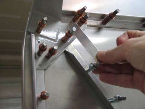

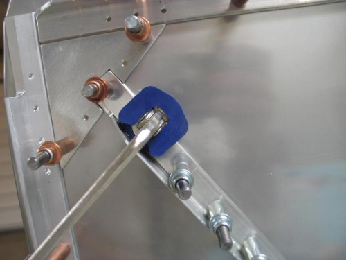

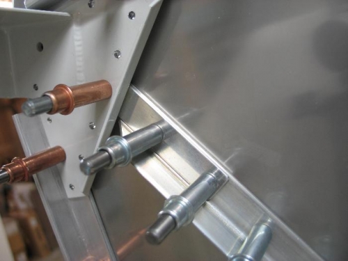

I made these 601P spacers earlier. Time to match drill them. It gets 3 holes (rivets). I clamped it in the middle and drilled the 2 outside holes. Then clecoed these 2 holes and drilled the center hole. Easy work.
Holdingthe 601P spacer.
2 holes drilled.
2 holes drilled.
Center hole drilled and clecoed up.
