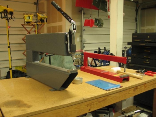

Brief Description:  DRDT-2 VS C-Frame
DRDT-2 on Left
C-Frame on Right
Can a DRDT-2 make quality dimples like the C-Frame.
Yes if you adjust more preload then you think you may need. The manual for the DRDT-2 says preload is important and to adjust it to give quality dimples. It say's "Typically preload is approximately an additional 1/4 turn beyond step 5". Well, I'm new at this so I adjusted it the 1/4 turn more then step 5 from the instructions. The dimples were concave (under dimpled) outside the actual dimple but being new at this I thought my dimples were as good as they get. Well, not so. To get a quality dimple that looks as good as the c-frame I had to go 3/4 turn past step 5 of the manual. After doing so I can not tell the difference between dimples made from either tool. Now, with different thickness material it may need to be re adjusted. I don't know yet. That's fine, it's easy to adjust and I now know how to recognize a quality dimple.
My tool of choice will be the DRDT-2.
