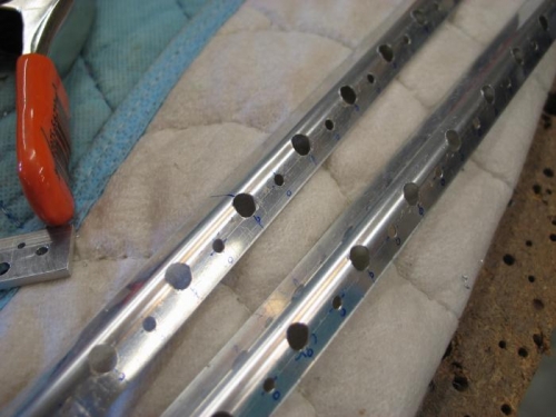

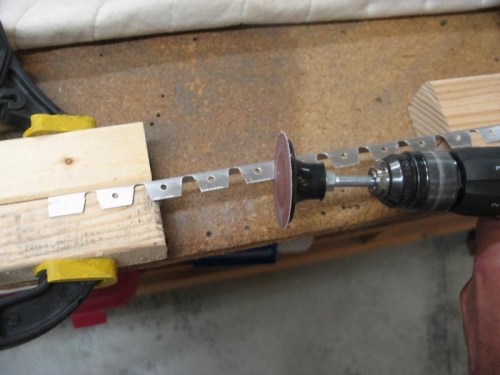

Now for the cut of the notches. I bet most builders used tin snips. I tried snips on some scrap and found I just could not avoid bending the flanges slightly. So, I used the band saw the same as I did when fabricating the F-703B angle. Over kill? Yep. No regrets though. I clamped the thin piece between 2x2's when using the sanding disk in my slow speed Matabo drill motor. Finished up with emery cloth and scotch bright pad.
Band saw to cut notches.
Slow speed sanding disk.
