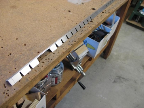

Brief Description:  Fab F-703B, Canopy Deck Angle, Part 3

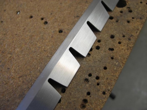

After all the notches are drilled and groves cut I used my die grinder with a sanding disk to smooth out the band saw rough grooves. Then finished it with strips of emery cloth. I left the angle 1/4” long at each end and will trim it to length after its actually fitted to the instrument panel.
F-703B notches finished.
Smoothed out and ready to fit.
