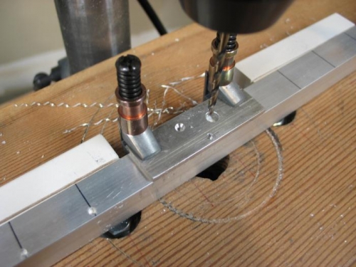

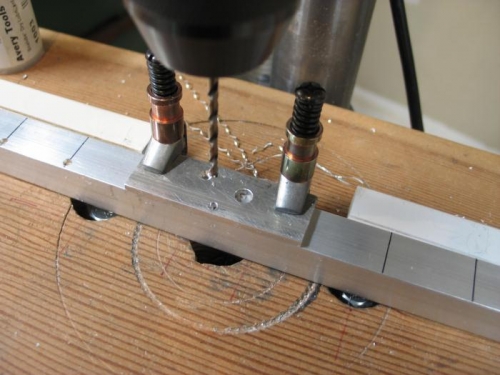

Brief Description:  Fab F-703B, Canopy Deck Angle, Part 1
This F-703B angle fits the back upper curve of the instrument panel. Needs to be notched so that it can bend and follow the curve. Use the plans to locate the notched positions. They are not equally spaced, so follow the plans. As seen here I used an 1/8th inch bit in the drill press. Also notice I match drilled through 1/8th inch thick aluminum plate as usual. I never free hand holes if I can match drill instead.
Match drill 1/8
Match drill 1/8" holes for notch.
I match drill everywhere.
