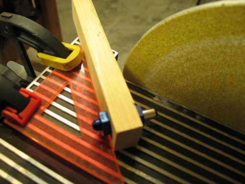

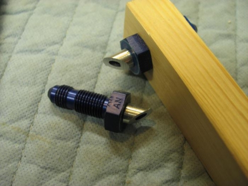

Brief Description:  Fuel Vent. Shape end to 45 degrees.

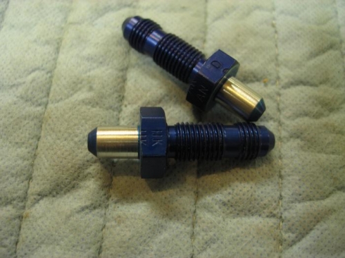

Fuel Vents. Next was to shape the end to 45 degrees. I could have just held the fitting up to the sander and sanded away using my eye and hand to get the 45 degrees. NOT. I decided to mount the fitting in a jig, instead of using my unsteady hand. Present the jig to the sander at 45 degrees. Much more precise. Happy with results.
Fuel Vent, Threads are gone.
Present to sander at 45 degrees.
Preciciese 45 degree.
