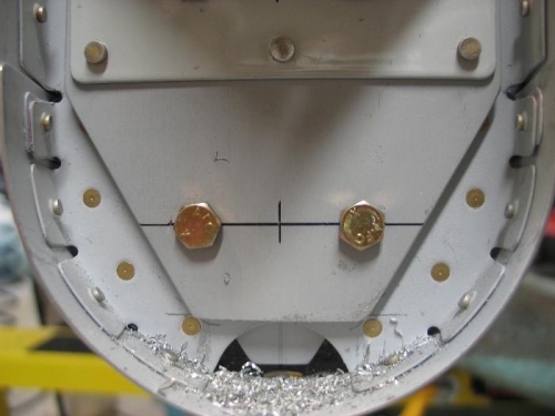

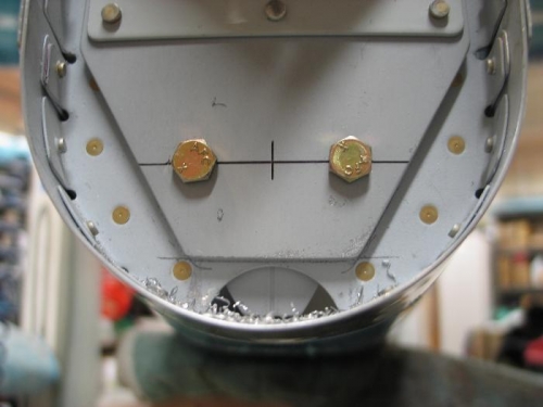

Brief Description:  Enlarge 6 holes holding on the VS to 3/16.
While drilling the lower 4 holes I was holding the tie down bracket by hand on the inside. Once all 6 holes that attach the VS rear spar are drilled to #30 (2 on the upper spar and 4 on the lower spar) , you enlarge them to 3/16 for AN3 bolts. These 2 images show precisely the location of the VS mail spar on top of the aft fuselage bulkhead. Next we’ll remove the VS, debur and rivet on the tie down bracket.
See position of VS to Fuselage.
