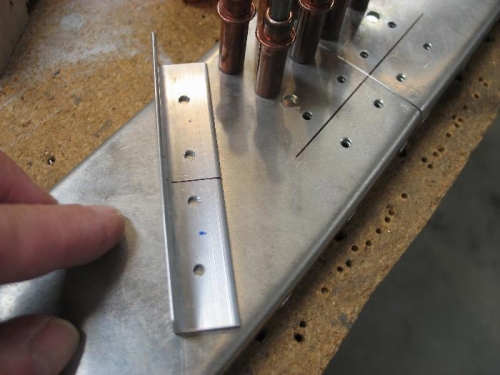

Brief Description:  Roll Bar - Bend and drill the 732D angle part 2.

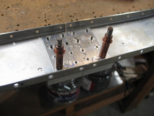

Just pictures, not very informative. Although notice the 4 holes in the channel. They are properly located. I’ve seen more then one building log that shows these holes very close to the vertex of the angle. The reason this can happen is that some builders locate the spice plate symmetrically vertical in the roll bar channel. This is wrong and doing this will put the 4 holes in the angle very close to the angle vertex. the plans call out the pattern of 16 holes through the splice plate to be symmetrical vertically but the splice plate is not centered in the channel vertically. The splice plate is located lower then vertically symmetrically. The plans show this but do not call out a splice plate location dimension. Weird.

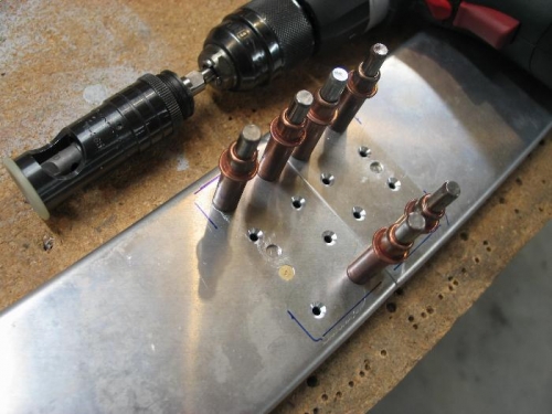

The front side of the roll bar needs to be counter sunk.
Splice plate not vertically symmetrical .
Holes properly located.
Counter sink forward channels.
