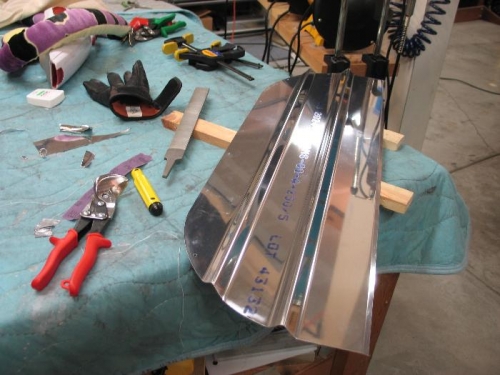

Brief Description:  Shape upper side of F-652 Baggage Bulkhead.
This bulkhead comes square, so the top edge needs to be trimmed away. Before you trim, mark and drill the location of the attach holes. Drilling the holes first gives you verification of your trim radius. I just used tin snips. As for drilling the holes, I still match drill any hole that I can instead going at it free hand. This may be overkill but I like doing it this way. If the drawing says put a hole here then by golly I want the hole there.
Trim radius marked on F652.
Matched drill attach holes.
Upper edge trimmed.
Upper edge trimmed.
