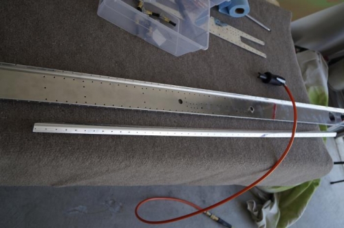

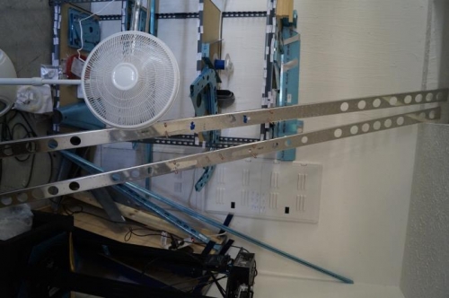

Horizontal Stabilizer Spars
- Deburred the horizontal stabilizer bars
- Cut and deburred the flange stiffeners for the HS
- Match drilled the flange stiffeners and spar doublers
I made one mistake on top of the forward spar in drillin #30 instead of #40. So those holes will get 1/8 rivets instead of 3/32.
Deburred spars with doublers
