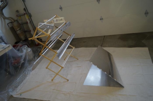

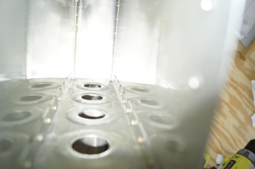

First, all the parts were primed (skins only on the inside) with AKZO 10P4 primer. This includes some prepping, like cleaning with degreaser and etching with etching fluid.

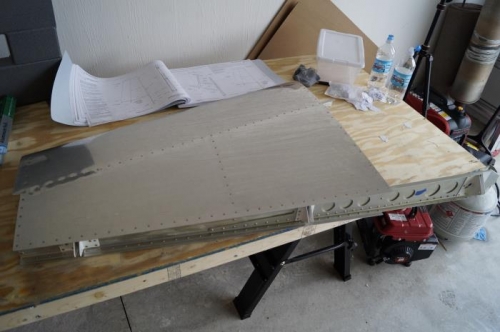

After the primer dried, all the parts were riveted together according to the plans (had to drill out a couple rivets, but the second trys were perfect).
I did not shake the primer well enought, so the parts mostly got a good epoxy coating without pigment. But that should protect it for the most part!
This concludes building the vertical stabilizer. Off to section 07
Everything is primed
