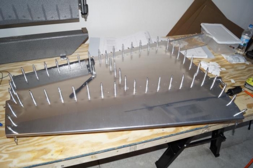

Fitted the Skins to the assembly
Match drilled the forward holes
Final drilled all the holes
I made a little mistake on the top rib VS-706. I originally had it upside down and it didn't fit. To make it fit, I sanded it down a bit. But now, the front two rivets do not reach any more.
I'll order a new rib. It's just 8$ and better safe than sorry.
