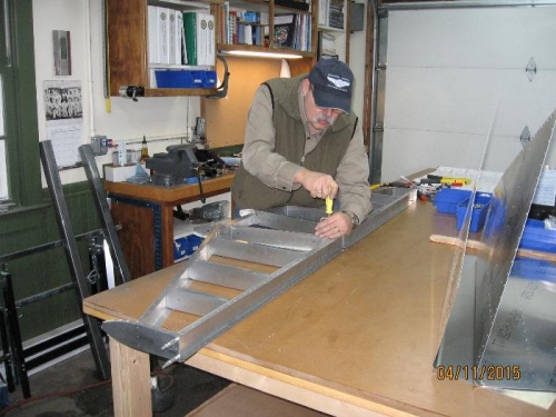

Did more work on the horizontal stablizer today. I got it all de-burred and riveted one side of the stabilizer.

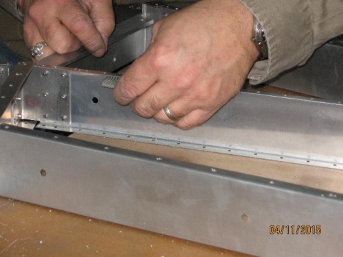

De-burring the stabilizer frame.

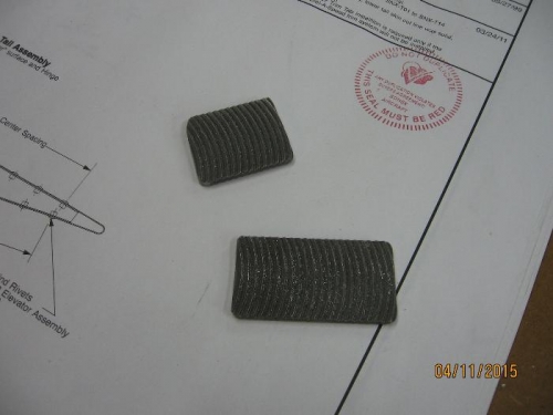

Using broken pieces of old vixen file to de-burr hard to reach spots.
Vixen file pieces I use to de-burr hard to reach spots.
