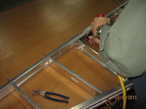

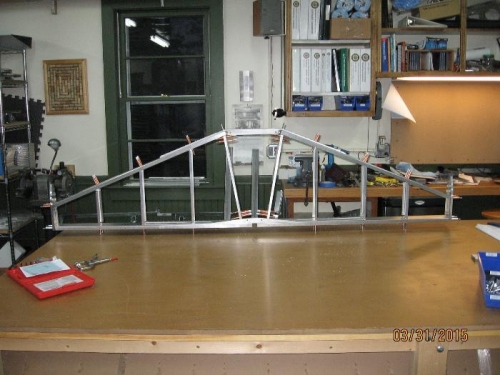

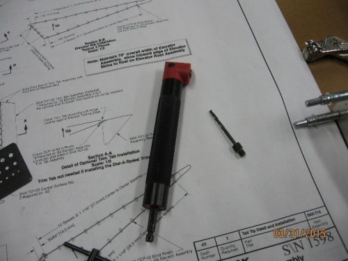

I worked on the horizontal stabilizer today, part #SNX-T02-01. I got this all cleco'd together and updrilled. I had to use the tight-fit drill attachment to get to some of the holes, since the space was so tight. I still need to attach the leading edge ribs, deburr all of the parts, and rivet them together.
Right angle drill attachment for drilling in tight spaces.
Using the tight-fit attachment to drill holes.
Horizontal stabilizer all up-drilled and ready for deburring and riveting.
