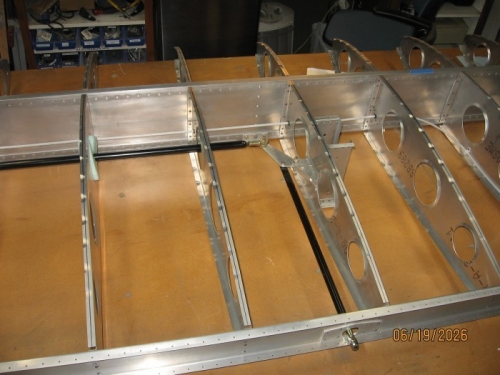

Brief Description:  Aileron controls
I connected up the aileron pushrods inside the wing skeleton before I start to skin the wings. I still need to properly torque down the castle nuts and add the cotter pins. I'll do this once I transfer the wings to the saw horses when I do the skinning.
Aileron pushrods connected up inside the wing frame.

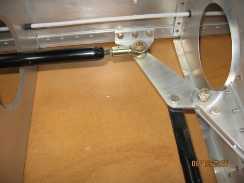

Pushrods connected up to the bellcrank assembly.

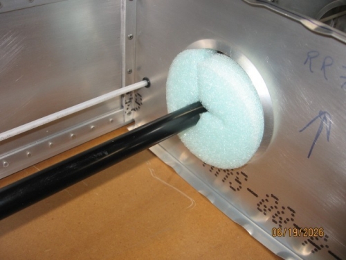

Foam insert in lightening hole to help support the long aileron pushrod.
