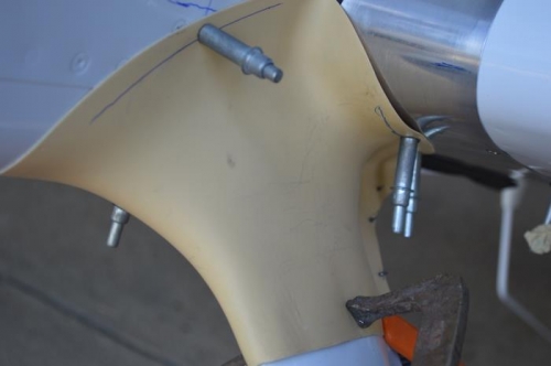

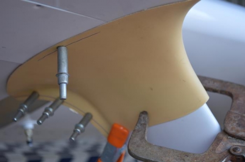

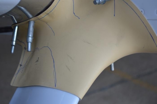

Brief Description:  gap farings and gear leg fairings
I found that I needed to trim the wing/fuse gap fairings a little more to aid in installation. Done so and they fit better and are easier to install now. Still hard but somewhat easier. Rubber seal mates up well with the fuselage. Fitted both upper gear leg fairings, They dont fit well at all. Done some persuading with a heat gun and got them closer. Marked and drilled for fasteners on both fairings.
Installed nutplates and tapped for fasteners on the fuselage and gap fairings. Fit is better now. I think I can get it now by using epoxy with microballons.
