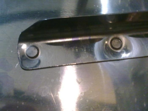

Seems I need to learn how to count. I used the gauge number 4 to check a rivet number 3 rivet. Don't do that, it flattens a rivet number 3 a little too much as you can see. When I have too much money I might replace this elevator
The stiffener is bending around the rivet

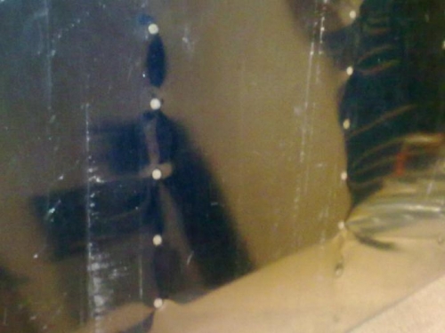

I can feel and see the bumps where I riveted

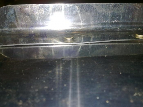

The stiffener is lifting up between the rivets
