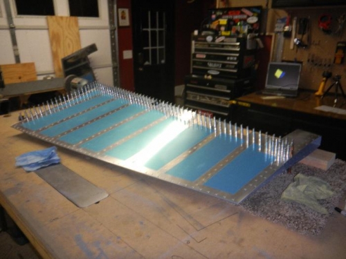

Finished riveting understructure and scotchweld sk
I got off a trip from work and my counterweight was at the front door.....For some reason it was not included in my second rudder kit.
I was able to get the counter weight counter sunk along with dimpling the rib with a #10 dimple.
I then mixed up a batch of S.W. and spreat it all over the understructure then clecoed on the skin.
Tomorrow My wings are due to arive!!!!!!!!!!!!!!!!!!!! I need to get this rudder done.
All scotchwelded up
