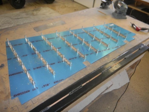

Brief Description:  Finished up left Stiffeners and Trimmed blue plast
Today I finished cutting the Stiffeners for the left half of the rudder. Then I used a scotchbrite wheel to debur followed up with some sand paper, deburring tool and finally a scotchbrite pad.
I then matchdrilled all of the left stiffeners onto the skin and trimmed off the blue plastic.....It works great to trim the blue plastic with the stiffeners clecoed on.
