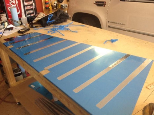

Started my productive day final trimming all of the stiffeners. I then fired up the soldering iron and took off the blue plastic. Then I clecoed on all of the stiffeners and match drilled. I finished up the day by dimpling the stiffeners and the skin.
After I got the stiffeners marked I used the first one as a guid for the rest

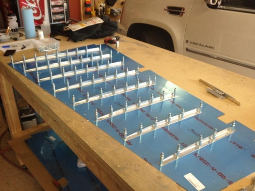

All the stiffeners done and clecoed on...ready for match drilling

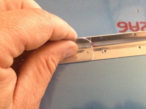

All the blue plastic taken off
