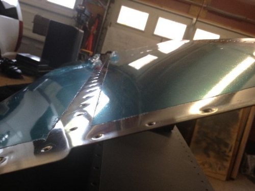

Brief Description:  Started on the Right side
I started on the right side of the HS. After alot of research I realized that I under dimpled!!!!! I was setting up my DRDT wrong. The way to do it is, adjust till the dies touch then give another 1/2 turn tighter. AW MAN, NOW WHAT DO I DO?
See how the dimples look.  The skin is distorted around each dimple.
