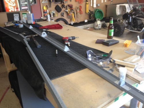

Brief Description:  More riveting

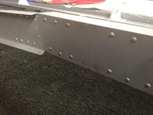

Riveted the 412 and 413 hinge brackets to the spar and then I ran out of 4-5 rivets....guess I and been practicing too much!!!! Then I bolted on the 411 hinge bracket and torqued it down to specs and added some torque seal. then I added the 810 amd 814 to the front spar. the squeezer wouldnt work to well for this so I fugured now was a great time to practice with the gun and bucking bar. Only had to drill out one rivet which went really well!!!! Then I decided to needed to order some 4-5 rivets and a offset rivet set.....the 404 and 405 rib seem hard to reach with the squeezer without bending back the ribs.
Had to buck all of these rivets...went very well
All of the spars riveted up
