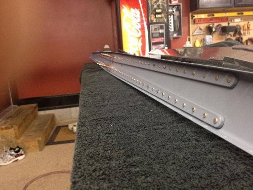

Brief Description:  AAAHHHH some riviting
Rived the 609PP spar channels with the pneumatic squeezer. Turned out great. I did alot of research on the shop head direciton. Some builders put the shop head to the inside some put it on the outside. I found some documentation saying to put the manufactured end on the thinnest peice of metal to prevent denting....sounded good to me!!!
