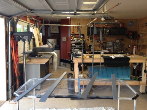

Brief Description:  Time to prime
I started off by scotchbriting all of the ribs and spard and ref. bars. Then, per a friend I used Colman Lanter fuel to wipe everything clean. Then shot all the parts with PPG DP40. Parts came out real good with my cheapo 15.00 HF paing gun. I decide to prep and shoot the skins tomorrow to make things a little more manageable.
All systems go!!!!  lets do this
All the parts are primed up and drying...on to the skins tomorrow
