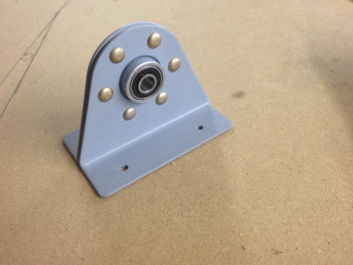

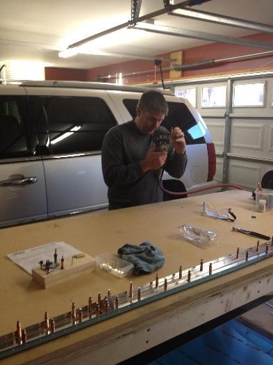

Match drilled, scuffed and primed the HS411. I have read on multiple build sites that the rivets that vans calls for is the -5 I almost used something bigger but read on a builders site that he tried a -6 and the rivet folded over. Which, required a drill out and -5 after all. I decide to use what the plans called for, and yes they do produce a slightly short shop head. Im sure vans would not steer us wrong on this.
