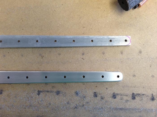

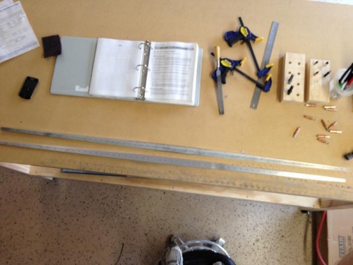

Brief Description:  1st Step 609-PP
Broke the edges of both HS-609PP spar reinforcement bars and rounded off the ends. I used a file to round off the end and them followed up with a run on the scotchbrite wheel. I then went over the whole thing with a scotchbrite pad to clean everything up.
