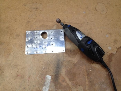

Next take everything back apart, deburr all the holes and cut out the aleron push rod hole in the 707E. I did this the same as everyone else, use a unibit to drill several holes and then take a dremel tool with a sanding drum and sand off the remaining aluminum to the line you just traced.

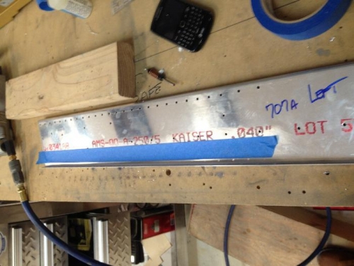

One last thing to do before calling it quits for the day. The manual says to go ahead and drill the flange holes on the rear spar where the 707G fork sits becuse once the fork is riveted in place it will interfere with rivet sqeezer. Make sure to put some tape on the spar to prevent the squeezer from scratching the surface.

using the dremel tool to shape up the aleron push rod hole

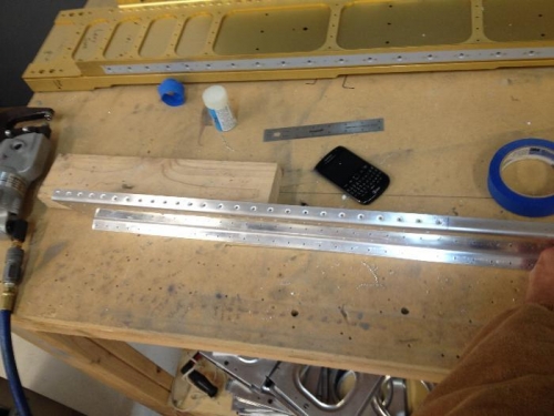

Tape place alon the spar to keep from scratching the surface while dimpling
Holes dimpled on the spar that woud be hard to get to once the 707G reinforcement fork is riveted on
