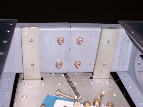

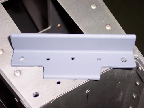

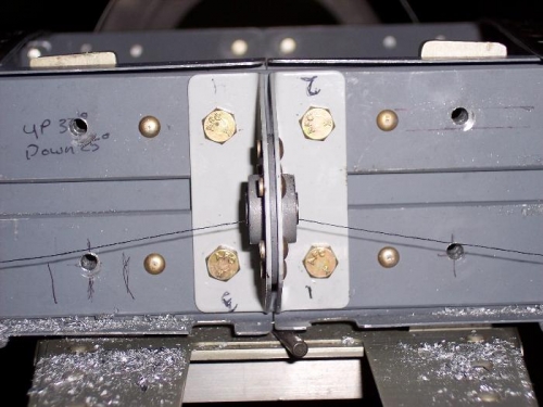

Drilled holes for the rear horiz stab spar and inserted bolts. Marked center line and clamped vertical stab onto fuselage, then noticed F-812B was not on fuselage. Removed vert stab and made F-812B and match drilled it to fuselage. Deburred prepped and primed F-812B. Measure, check, measure, check…repeat.
