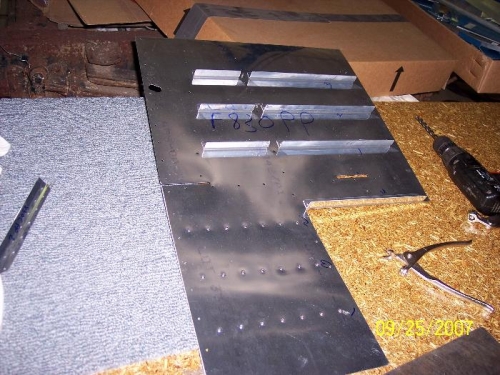

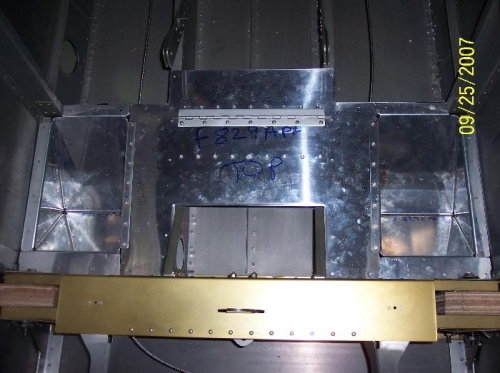

Match drilled, deburred, dimpled and riveted F-829 fwd floor and rear footwellls together. Match drilled, deburred, dimpled and riveted stiffeners to F-830L floor, except for the front ones. Drilled holes in rear seatback attach hinge.
