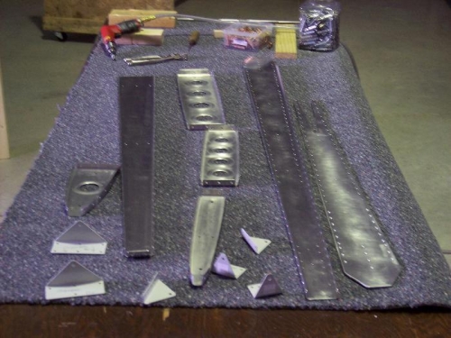

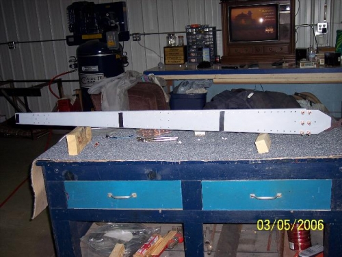

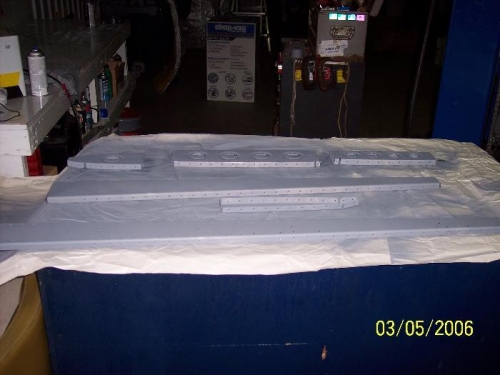

Deburred VS ribs and spars. Dimpled ribs and spars evcept VS803-PP where VS-808PP spar doubler needs flush rivets. Countersunk spar doubler. Discovered I didn't match drill one side of VS-705 so I re-clecoed the VS and match drilled them, then disassembled...again.Primed all VS internal parts. Riveted top and center VS hinge brackets to rear VS spar.
