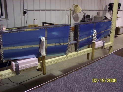

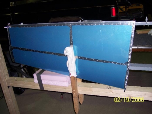

Riveted bottom of HS707 rib to skin. Built fixture to hold left and right side horizontal stab for easier riveting of skin to ribs and spars. Clecoed and riveted right side fwd spar and center ribs to skin. Clecoed rear spar to left and right skin and ribs. Riveted left side bottom skin to rear spar.

Fixture. Yes...those are socks.
Bottom left stab.
Bottom left stab.
