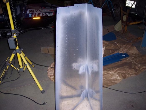

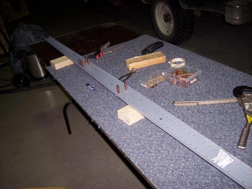

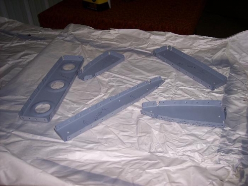

Finished deburring right side horiz skin HS-801PP. Dimpled HS-801PP. Touched up RH side ribs, spars and edges and scratches with primer. Riveted HS-609PP to right side HS603PP spar. Checked all rivets with gauge. They seem a little short, but the manual says the -6 rivets are the correct ones.
