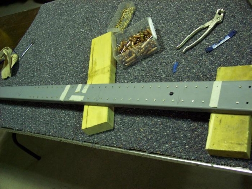

Date:  1-25-2006
Number of Hours:  3.00
Manual Reference:  Page 6-3
Brief Description:  Left HS

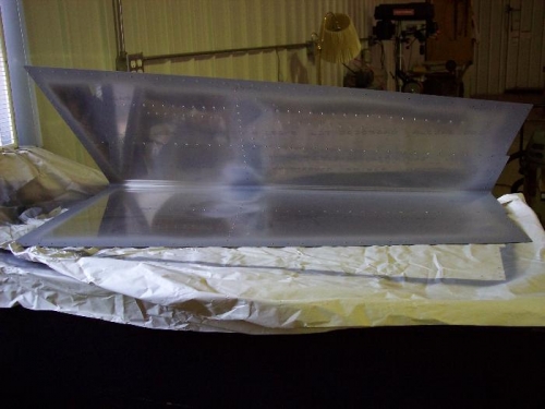

Dimple front left spar HS-706. Finish dimpling HS-801PP. Used close quarters dinple dies on the two most forward holes. Touch up primer on ribs and put thin coat of primer on inside edges and any scratches on inside of left HS-801 skin. Riveted HS-609PP bars to HS-603PP left side spar.
