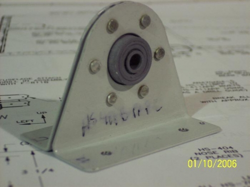

Brief Description:  My first rivets
Primed VA-146 with NAPA 7220 and riveted between HS-411APP and HS-411BPP using squeezer. Match drilled completed assembly to rear spar. Match drilled all HS-411PPs to rear spar with #12 drill. Marked and disassembled rear spar assembly.
Found HS-702s and alligned in jig then clecoed HS-810-1 and HS-814-1 to them.
The first six rivets!
