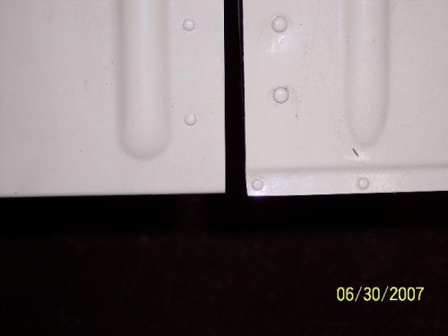

Date:  6-29-2007
Number of Hours:  2.50
Manual Reference:  Pg. 7-12
Brief Description:  Left flap

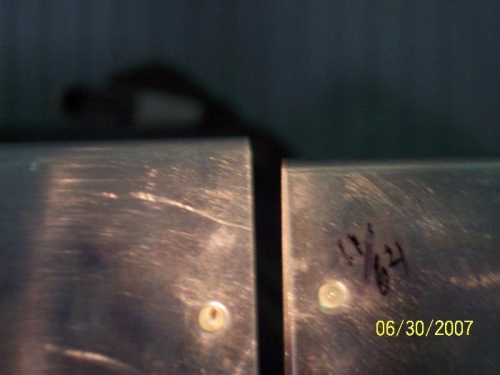

Primed and riveted left flap brace to rear spar. Installed left aileron and clamped to neutral. Put "keeper" rivets in aileron brace to lower inboard skin. Clamped flap hinge and flap to wing and aligned. Trailing edge does not align with aileron trailing edge. Called Van's and that's normal. Image 2 and three are from a Cherokee six for comparison.
