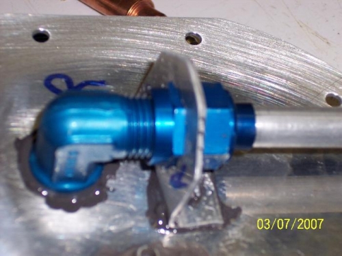

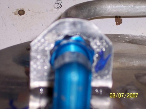

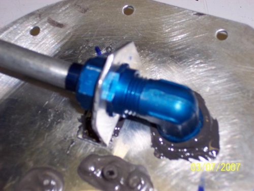

Final installed left and right fuel tank covers and fuel level sending units Used Stewart Warner 385-F from Van's. Used Flamaster CS 3204 sealing compound from Van's. Batch number A-0607011
B-0505003, Exp date 4/07. No gaskets were used, just sealer. Torqued both AN924-6D nuts to AN833-6D elbows to 100 inch pounds. Used extra sealer on conduit inside wings.
Right anti rotation bkt
Left a-r bkt
Left a-r bkt
end view of a-r bkt
end view of a-r bkt
