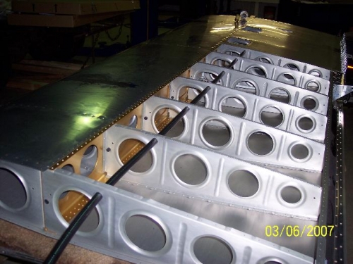

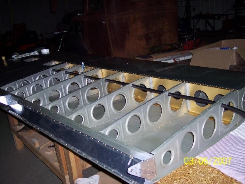

Flipped left wing. Installed conduit in left wing. Put right wing on table and finished drilling holes for conduit. Installed conduit in rightt wing. Checked left fuel sender. Full 31, empty 247. Assembled fuel tank cover and fuel sender. Bent float control rod per plans. Cleaned all screws and rivets with laquer thinner. Prepped mating surfaces with scotch brite pad and laquer thinner. RH fuel pick-up tube was torqued to 75 inch pounds to mesh with hex anti rotation bracket.
