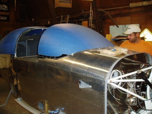

Tonight we glued the windscreen to the fuselage. We made wedges out of plastic to put between the rollbar and the windscreen. We just kept moving the wedges until the slider lined up with the windsreen, and then we applied the glue. After the glue dries we will pull out the wedges and finish gluing.
windsreen after glue

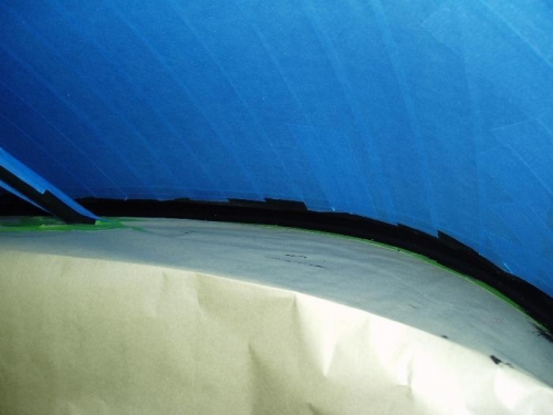

Its tough to see but thats the fillet on the inside of the windscreen
