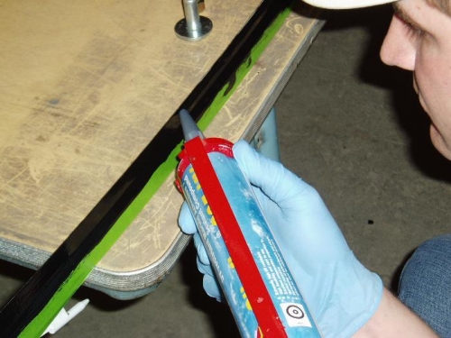

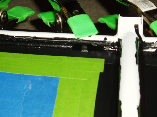

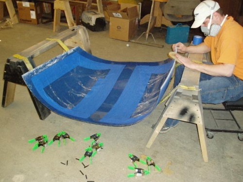

Glued canopy to frame
Using the sicaflex system we skuffed the plexiglass and canopy frame, then cleaned and primed the mating surfaces. Finally we glued it down and clamped it. There are no rivets so hopefully the glue will hold it
